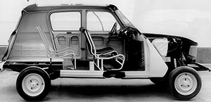

The Renault 4 was produced in 3 body stylies – 2-door pickup truck, 2-door van and 5-door hatchback. The car was powered by 0.7, 0.8, 1.0, 1.1 and 1.3 litre petrol 4-cylunder watercooled engines with 3- or 4-speed manual gearbox.
And here is something about the car – the left wheelbase is shorter than the right one with 2 inches. Strangely, a?
The rear torsion bars are located one behind the other, so the wheelbase is longer on the right side than on the left.
The Renault 4 remained a basic car throughout its life, nonetheless offering a comfortable ride, due to well-designed suspension, a habitable interior due to comfortable seats, powerful heater and effective ventilation. Windows used sliding mechanisms. The dash-mounted gear lever created a flat floor and passed over the longitudinal engine and clutch to the gearbox at the front.
