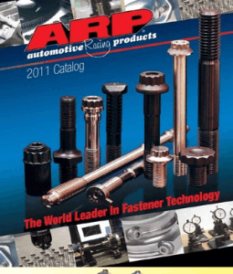

العودة   مصر موتورز مجتمع السيارات > السيارات الأوروبية > سكودا skoda
سكودا skoda اسكودا Škoda بداءت كشركة تشيكية منذ عام 1895 على يد شريكين لورينما وكليمنت وهى حاليا احدى شركات مجموعة فولكس الالمانية من اهم موديلات سكودا اوكتافيا فابيا رومستر
  #16
قديم 11-11-2012, 04:16 AM
Smile Metrology 3D scanner
المشاركة الأصلية كتبت بواسطة Vanditta مشاهدة المشاركة
تقريبا فى مشكلة فى الملفات المرفقة
على العموم دة محتوى ال pdf اللى كنت عايز ارفعة
for Cars Admire and Mr-astra
TORQUE TO YIELD HEAD BOLTS
There is a lot of controversy about torque to yield head bolts, also known as angle torque,
torque to turn, wasted or stretch bolts. How are they different? Can they be reused or do they
need to be replaced? I would like to clarify some issues regarding these types of bolts now
commonly in use in the automotive industry
FIRST SOME HISTORY
While modern engines have become more fuel efficient, fuel consumption is mainly a
function of vehicle mass. The need for heavier structures due to stringent safety regulations
and added safety features that are now mandatory has caused increases in vehicle mass. In an
effort to contain these increases the designers are forced to strive for reduction in mass in
other components. In the case of cylinder head bolts the mass of ten 12mm x 125mm long
bolts are 1.1kg; for the same number of 10mm bolts in the same length is 600 grams. If the
smaller bolt bosses in the cylinder head and block are added, the total saving could be easily
one kilogram. This is a significant amount for just one engine component! TTY head bolts
offer a number of other advantages for the engine manufacturer, which include flexibility in
cylinder head design as this type of clamping style can require less head-bolts, and there is
also a reduction in material costs. Another major advantage for the manufacturer is a more
controlled cylinder head clamping torque.
HOW DO CONVENTIONAL HEAD BOLTS
WORK
When a conventional bolt is tightened it stretches slightly. When the tension on this bolt is
released it will recover back to its original length. This phenomenon is called elasticity. A
conventional bolt therefore can be reused, over and over, as long it is not over-tightened.
Typical maximum loading of a conventional head bolt is 20% short from its yield point.
WHY TORQUE TO YIELD HEAD BOLTS THEN?
To generate the necessary clamping load the smaller diameter torque to yield head bolts must
be tightened to near their maximum permitted stress levels. To achieve this the TTY head
bolts are tightened past their yield point into the plastic phase. The yield point or yield
strength is the maximum load that can be applied to a bolt without causing plastic
deformation. In other words if the bolt is tightened past its yield point it will not return to its
original dimension or state when the loading is released. This is due to plastic deformation! If
the bolt loading is increased even further the bolt will quickly reach its ultimate tensile
strength point and the bolt material wastes and breaks. This is the reason that the TTY head
bolts should not to be under or over-tightened and why an accurate system of tensioning is
required
When conventional bolts are tightened they generally have a final torque figure in imperial
foot pounds (Lb.-ft) or metric Newton meters (N.M.). This is a relatively inaccurate method
of fastening as 80-90% of the clamping load is lost to friction. The torque-to-turn method
reduces inaccuracies significantly because the initial torque figure is often low, so any friction
variations have a much smaller effect on the end result
CAN TTY HEAD BOLTS BE REUSED?
Due to the nature of their design these bolts do wear out and often cannot be reused. Unlike a
conventional bolt the TTY bolts are tightened well beyond their yield point into the plastic
phase. Furthermore the head bolts will stretch even further during service when fitted to an
Aluminium cylinder head. Aluminium alloy has roughly twice the expansion rate of steel and
the head bolts need to compensate for this. If these types of bolts are to be used a second time
or any subsequent times thereafter, the already permanently stretched bolts will stretch even
further and rapidly lose clamping load. The loss of clamping load could ultimately lead to
head gasket failure
The end user will ultimately have to pay for the extra cost of new bolts
when replacing a head gasket, but this is a relatively inexpensive form of insurance against
future head gasket failure
Metrology 3D scanner
just only for you
Vanditta
the link
http://blog.nikonmetrology.com/tag/3d-scanning/
:GR OWIN~12::GROWI N~12:
link
http://www.armstrongtools.com/newproducts.aspx
التعديل الأخير تم بواسطة cars admire ; 11-11-2012 الساعة 04:25 AM
  #17
قديم 11-11-2012, 10:44 AM
الصورة الرمزية mr_astra
تاريخ التسجيل: Oct 2010
المشاركات: 6,811
افتراضي رد: مياة الرداتير عتجنينى
"Vanditta" اولا بشكرك جدا جدا جدا على موضوعك الدسم والذى يحمل افادة كبيرة لكل اللى قراة وانا شخصيا استفدت جداااااااا منة
ومش مقصود طبعا اننا نغلطك .....كلامك عين العقل لكنة مش موجود على ارض الواقع ...هى دى امكانياتنا ودة السوق بتعنا وبنحاول ندى اجابة على ما هو متاح بالسوق بغض النظر عن قيمتة الفنية
السوق مفهوش مسامير صلب وكولة كلام فى الهوا ودمغ وخلاص ..... ما فيش نحاس جرافيت فى السوق عشان تعمل منة جلبة محترمة كولة نحاس اصفر نصفة حديد .... بتتعامل مع اردا خامات واحقر الماركات وكولة صينى درجة عاشرة لا ترقى الى الاستخدام الادمى
دول بيقلدو الدواء والاغذية اللى ممكن تقتل انسان مش هايقلدو مسمار ولا صامولة ولا حتى تيل فرامل
بجد انا بحسد الناس الاجانب فى عيشتهم
انما انا وانت بنتعذب من اول ما نقوم من النوم لغاية اما ننام والله لو جبت حجرين قلم لابنك يحطهم فى اللعبة بتعتة هتلاقيهم بيظين
يااااااااااااا رب
إرحمنا بقدرتك علينا
  #18
قديم 11-11-2012, 01:11 PM
افتراضي رد: مياة الرداتير عتجنينى
ما فيش نحاس جرافيت فى السوق عشان تعمل منة جلبة محترمة كولة نحاس اصفر نصفة حديد .... بتتعامل مع اردا خامات واحقر الماركات وكولة صينى درجة عاشرة لا ترقى الى الاستخدام الادمى
:GR OWIN~12::GROWI N~12:
  #19
قديم 11-11-2012, 02:56 PM
الصورة الرمزية amr elsisi 1
التخصص العملى: مفتش صيانة
المشاركات: 2,464
افتراضي رد: مياة الرداتير عتجنينى
Vanditta"
mr_astra
احلي صباح لاحلي اصدقاء واحلي علم
احب احي صديقي Vanditta علي هذا المجهود
واحب اضيف معلومة في عملي
مسامير الرباط الموجودة داخل حرارات
والتي يتم الرباط عليها بعزم اربع ايام متتالية
عند فكها لايجوز استعمالها مرة اخري
لان المسمار اخذ مقدار الاستطالة الخاصة به
ولذلك لايجب ان اعطية استطالة مرة اخري
والا سوف ينكسر
واحب ان اضيف معلومة اخري بالنسبة للصواميل الكونتر
وتنقسم الي نوعان
1:صامولة كونتر بداخلها رنج كاوتش اقل من قطر الصامولة
2:صامولة كونتر اولها نفس القطر ولاكن بيضاوي
وفي كلا النوعين لايجب ان تعاد استخداها مرة اخري
لان سن المسمار اصبح مطبع علي هذا الشكل
ولن يعمل بعد ذلك بنفس الكفاءة
]من اهم مواضيعي المصورة
  #20
قديم 11-11-2012, 03:35 PM
الصورة الرمزية mhamdy75
تاريخ التسجيل: Jun 2009
المشاركات: 6,395
افتراضي رد: Metrology 3D scanner
Metrology 3D scanner
just only for you
Vanditta
the link
http://blog.nikonmetrology.com/tag/3d-scanning/
:GR OWIN~12::GROWI N~12:
link
http://www.armstrongtools.com/newproducts.aspx
:GR OWIN~12:
مهندس / محمد حمدى
الساعة الآن 10:53 AM.
