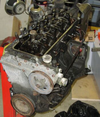

Here's the long block. Starting to look more familiar.

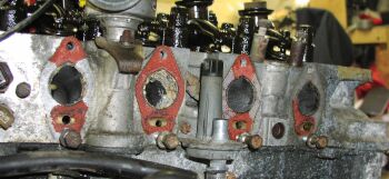

Look at the #2 intake port. Is that from coolant?

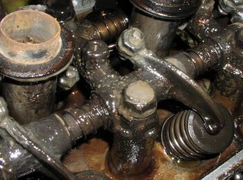

Look at the caramel sauce-like guck on the adjuster screw and head bolt. Is that an oil/coolant emulsion? That doesn't bode well for the bottom end.

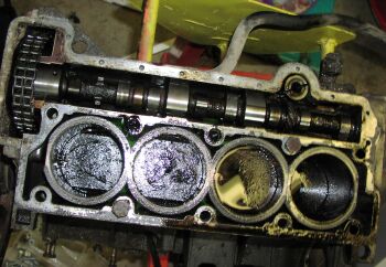

I managed to get the head off without dislodging the liners. The bores were bone dry and acutally had loose carbon dust inside that needed to be vacuumed out. the combustion chambers were surprisingly free of crud, one was a little blacker than the others. Unfortunately the engine is seized somewhere, the liquid you see is penetrating oil. I wonder what happened when the gasket let go? We'll find out.

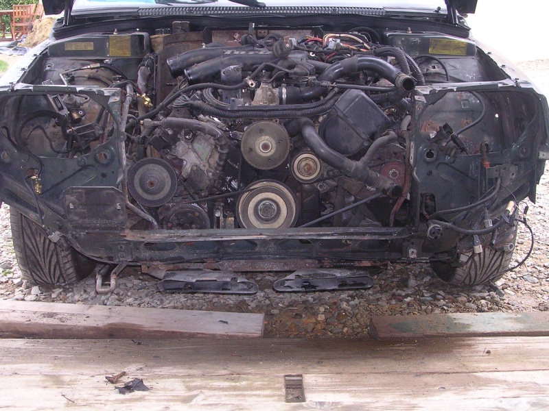

ركب على الفويجو 6 سلندر بتربو ومن غير تربو كمان !!!!!!!!!!!!
ده احتمال يكون شكل ال25 الجديدة !!!!!!!!
